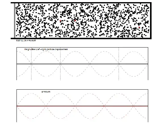

(Here is an image of a standing sound wave, we'll just need to imagine this on its side) Standing sound wave
It is obvious that these are nodes and anti-nodes in this standing wave. The anti-nodes are the places where the pressure fluctuates the most, these are the places where they contract and extend the most. The places in between, where there is a constant air movement ,the pressure is the lowest (Bernoulli).

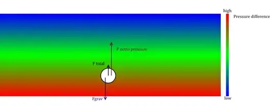

It is easy to grasp that when there is an upward force lifting the ball when there is a high pressure below the object, lifting it and counteracting gravity Sound wave lifting

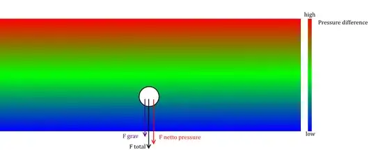

This is where most websites leave their answers, however, standing sound waves change over time. This means that a fraction of a second later this happens for an equal amount of time! Sound wave lifting
And in between the changing there is even a short moment (theoretically) in which there are no pressure differences and only gravity pulls the object down. Not to mention that such flips of pressure happen over 23000+ times a second for a regular acoustic levitator.
If this pressure force is constantly changing in an equal and opposite direction how can it lift objects mid-air? The machines work in real life, so how exactly does this work?
