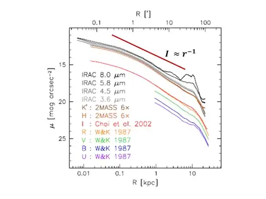

Below I show an example (using surface brightness) for M31 (taken from Corteau et al. (2012)), using various luminosity indicators, on which I have marked a $\rho \propto r^{-1}$ dependence. A $r^{-1}$ does work reasonably in the inner part of the disk (it is actually a bit shallower than that because of the bulge), but at some point $r> 10$ kpc, the luminous matter just runs out and the observed intensity distribution becomes steeper than $r^{-1}$.
M31 azimuthall averaged intensity

i.e. Your analysis that a $\rho \propto 1/r$ relationship leads to a flat rotation curve is roughly correct. However, the fact that intensity in our Galaxy (and others) falls off more steeply than $r^{-1}$ in the outer parts of the Galaxy leads to the conclusion that the matter is ... dark! There is an additional problem with the normalisation as well. Even in the inner parts of the disk, the mass implied by the luminous matter is insufficient (by factors of a few) to explain the rotation speeds.
So now to answer the last part of your question - how do we know that $\rho$ (of luminous matter) does not fall as $1/r$ in the disk. This is just a question of counting up stars and estimating the contribution of gas from HI surveys (and dust, though this is negligible). There is no single source of this information (though here is an example I pick at random that uses SDSS number counts), it is agglomerated from many different surveys at different wavelengths and built up to give a coherent picture. The underlying assumptions are that we understand the types and mixture of stars that make up the overall stellar populations. Our understanding could be incorrect, but the way in which it would need to be incorrect to explain rotation curves is to have lots (and I mean orders of magnitude) more dim stars that contribute mass but no light at large radii (i.e. dark matter, though baryonic, which doesn't help you with other pieces of evidence for dark matter).
For example, the luminosity of the M31 data shown above drops off steeper than $r^{-1}$. If you were to extrapolate a $r^{-1}$ relationship, then to ensure that the mass did go as $r^{-1}$ you would need the mass to luminosity ratio to increase by some factors of ten. To do this would require orders of magnitude more faint stars to bright stars than are observed in the local disk.
