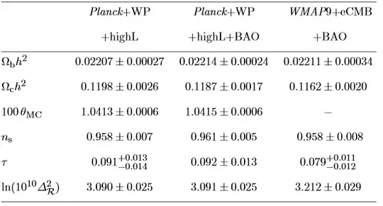

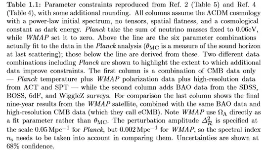

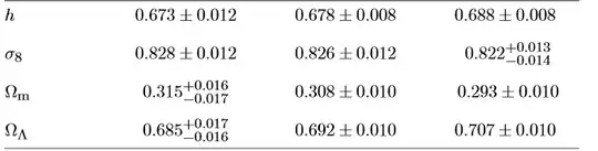

Transferring from the comments, as they do have a tendency to disappear:
There are two useful references given by @yess, one a Planck publication, the other a comprehensive report on the cosmological parameters.
From the latter is is evident that sigma_8 is derived from other fitted to data parameters .
c1 c2 c3
One should read the references for a comprehensive view.
