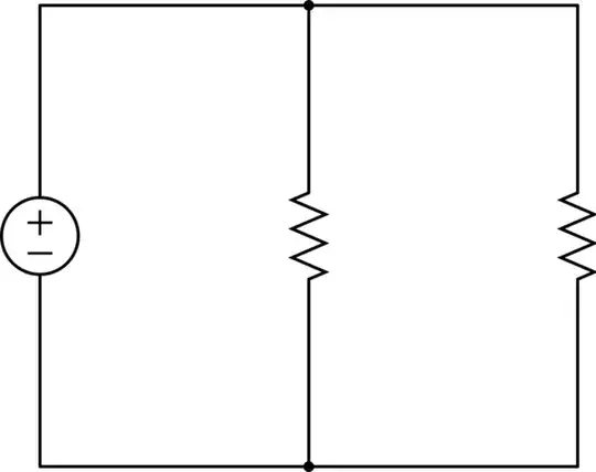

Suppose I have a complicated electric circuit which is composed exclusively of resistors and voltage and current sources, wired up together in a complicated way. The standard way to solve the circuit (by which I mean finding the voltage across, and current through, each circuit element) is to formulate Kirchhoff's laws for both current and voltage, and these will yield linear equations which enable one to solve for all the relevant quantities.
However, there are two problems with these laws:
  • There are too many of them. For example, in the simple circuit below, there are three different possible loops one can draw, but only two independent voltages. Similarly,
  • The equations are not all independent. In the circuit below, the current conservation equations for the two different nodes turn out to be exactly the same equation.
Fortunately, in real life, these problems happen to exactly cancel out, and one gets exactly the correct number of equations to solve the circuit. There are never too many contradicting constraints (the linear system is never overdetermined) and there are always enough equations to pin everything down (the linear system is never underdetermined).
Why is this? Is there a simple proof of this fact? What are the fundamental reasons for it?

Here's a counterexample:
Suppose two identical, ideal batteries (with zero internal resistance) are both connected in parallel across a single resistor; equivalently, replace one of the resistors in your diagram with a second, identical battery. Also assume the conducting wires are ideal (again, no resistance).
Kirchhoff's laws in this case result in an underdetermined system. If the current through the single resistor is I and the voltage across both ideal batteries is V, you cannot find the current through either battery using Kirchoff's laws alone; both loops give the voltage across the resistor as V, and both junctions say the sum of the currents through the batteries must equal I, but do not allow you to calculate either of those currents. For instance, a current of 3 I up through one battery and 2 I down through the other satisfies the system of equations. In this case you have to use a symmetry argument to conclude the current through each battery is I/2.
This is not a problem using real-world equipment, though, as voltage sources always have some amount of associated internal resistance. So if we agree to use non-ideal circuit elements, then I agree with the answer @Hu provided.
This indirectly raises another question; are Kirchoff's laws meaningful in ideal circuits? I'm sure there are many more examples like the one above, where the resulting system of linear equations is underdetermined (though I doubt there are cases which are overdetermined). We use ideal situations to model real systems, but is that a good idea when answers are undetermined in the ideal case?

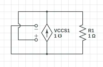

Here's a simple ideal circuit, consisting of a voltage controlled current source (VCCS) and a resistor, where the resistor current $I_R$ is undetermined by the circuit equations:
The voltage across the resistor (top terminal is positive) is given by Ohms law:
$$V_R = I_R\cdot 1\Omega$$
The VCCS control voltage equals $V_R$ by KVL, and the resistor current equals the VCCS current by KCL. Thus, the resistor current is given by
$$I_R = V_R \cdot 1\mho$$
and so the circuit equations yield
$$ I_R = I_R\cdot 1\Omega\cdot 1\mho = I_R$$
That is, any value for $I_R$ solves this circuit.
Update to address this comment:
The question lists what components are allowed. A VCCS isn't one of them. – Ben Crowell 1 hour ago
In fact, the question lists (1) resistors, (2) voltage sources, and (3) current sources as the allowed components according to the opening sentence:
Suppose I have a complicated electric circuit which is composed exclusively of resistors and voltage and current sources...
Now a VCCS is a current source. The term "current source", unqualified with either independent or dependent (controlled), may refer to either type.
An ideal current source generates a current that is independent of the voltage changes across it. ... If the current through an ideal current source can be specified independently of any other variable in a circuit, it is called an independent current source. Conversely, if the current through an ideal current source is determined by some other voltage or current in a circuit, it is called a dependent or controlled current source.
It may be that Emilio is only interested in circuits with independent sources for this question. But it certainly isn't the case that the question explicitly states that, nor is it the case that one could rationally conclude that dependent sources are obviously excluded from consideration.
So, unless and until Emilio edits his question to explicitly state that only circuits with resistors and independent sources are to be considered, I will leave this answer as is.
