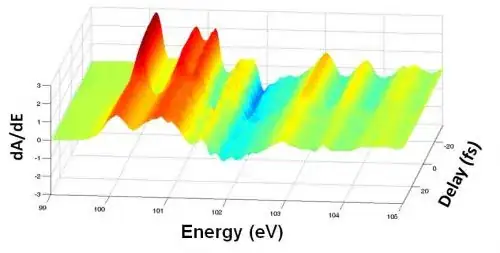

I believe that the currently attainable limit of imaging is around 10's of atto-seconds per time slice (around 10^-17) from which it is possible to observe individual state transitions of an electron in silicon (which takes around 450 atto seconds, or about half a femto-second).
as per Ryan Colyer's answer, uncertainty can prevent imaging in a single pass, but with repeated imaging passes the uncertainty can be overcome.
enter image description here from http://phys.org/news/2014-12-attosecond-laser-movie-fast-electrons.html
