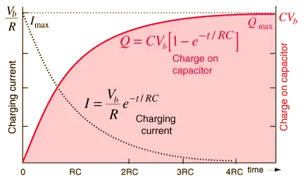

Between start and some long time $t$ later, charge will gradually build up towards it's max-value and therefor current will gradually decrese towards zero (corresponding to resistance gradually increasing towards infinity), as this graph shows:
The dotted line is the current - it starts high, and ends low. The red line is the charge build up. The voltage over the capacitor is constant, so if you want to find the equivalent "resistance" $R_{eq}$ (which will change with time), use Ohm's law:
