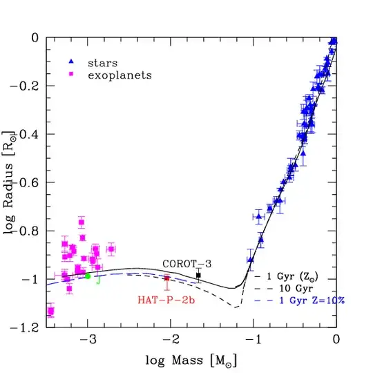

The plot below shows some theoretical models compared with some observations from Chabrier et al. (2008). This covers both stars and planets. Notice how the radii of low-mass stars basically decrease (proportional to mass) as the mass decreases and hence $\rho \propto M^{-2}$. But these are supported by perfect gas pressure. As we approach the brown dwarf regime and higher internal densities the electrons become (partially) degenerate and the character of the curves changes and flattens.
Data for transiting exoplanets is also shown. They show a diversity of radii at a given mass that is not completely explained at the current time. Some of it is almost certainly due to irradiation by the parent star (these are almost all "hot Jupiters"). But there may also be composition effects.

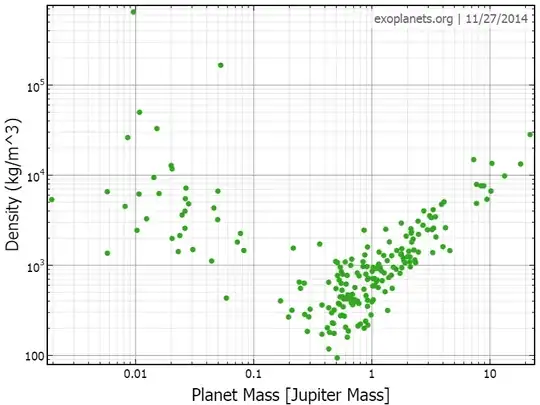

Note that the $R \propto M^{-1/3}$ behaviour applies roughly between about a few Jupiter masses and 70 Jupiter masses. At lower masses there are various interactions with the ions, Thomas-Fermi corrections etc. that change the ideal degenerate gas behaviour and flatten the relation. This means that when we plot density versus mass for exoplanets, we find that density is proportional to mass (i.e. that the radius is roughly constant). See below - data extracted from exoplanets.org. Below a tenth of a Jupiter mass, the equation of state become much more incompressible and the behaviour changes again.
For normal low-mass stars, the central temperature does not vary a great deal. It is set by the ignition of the pp-chain. Thus the central pressure is $\propto \rho$ for a perfect gas. If you insert this into the treatment I gave above for degenerate stars you find that $R \propto M$ and indeed, the average density of low-mass stars higher.
Density vs mass from exoplanets.org
