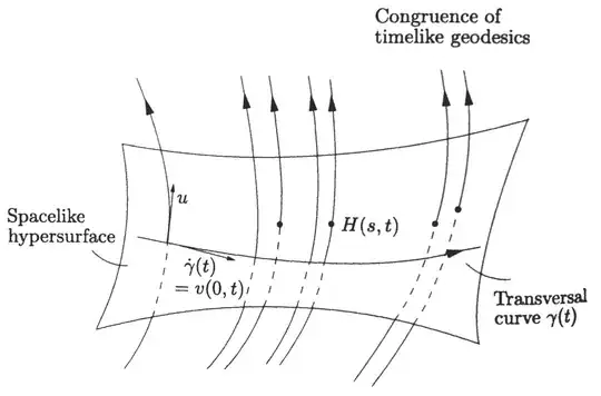

Definition 1. Consider a family of timelike geodesics, having the property that in a sufficiently small open region of the Lorentz manifold $(M,g)$ precisely one geodesic passes through every point. Such a collection is called a congruence. The tangent field to this set of curves, parameterized by proper time $s$, is denoted by $u$ and is normalized as $\langle u,u\rangle=-1$.
Let $\gamma(t)$ be some curve transversal to the congruence. This means that the tangent $\dot\gamma$ is never parallel to $u$ in the region under consideration. Imagine that every point on the curve $\gamma(t)$ moves a distance $s$ along the geodesics which passes through that point. Let the resulting point be $H(s,t)$. This defines a map $H:O\longrightarrow M$ for some open $O\subset \mathbb{R}^2$. For each $t$, the curve $s\longmapsto H(s,t)$ is a timelike geodesic with tangent vectors $u(H(s,t))$. We say that $u$ defines a vector field $u\circ H$ along which the map $H$ is tangential, i.e. of the form $$u\circ H=H_*\circ\frac{\partial}{\partial s}\quad\text{or}\quad u\big(H(s,t)\big)=T_{(s,t)}H\cdot\frac{\partial}{\partial s}$$ In other words, $u$ and $\partial/\partial s$ are $H$-related. We shall use for $u\circ H$ the same letter $u$. Let $v$ be the tangential vector field along $H$ belonging to $\partial/\partial t$ $$v=H_*\circ\frac{\partial }{\partial t}$$ The vectors $v(s,t)$ are tangent to the curves $t\longmapsto H(s,t)$ ($s$ fixed), and represent the separation of points which are moved with the same proper time along the neighboring geodesics of the congruence (beginning at arbitrary starting points). This is shown in the following diagram (taken from Straumann, General Relativity [2013]):enter image description here
Since $\partial/\partial s$ and $\partial/\partial t$ commute, the tangential fields $u$ and $v$ also commute. To see this, recall that if the vectors of two Lie brackets are $H$-related, then the Lie brackets themselves are $H$-related.
To get the distance between curves, we create a projection operator $id+u\otimes u$ onto the subspace of the tangent space orthogonal to $u$. Thus the relevant infinitesimal separation vector $n$ is $$ n=v+\langle v,u\rangle u $$ Note that $\langle n,u\rangle=\langle v,u\rangle-\langle v,u\rangle=0$, so $n$ is indeed perpendicular to $u$. We now show that $n$ is also Lie transported. We have \begin{align*} \mathcal{L}_un&=[u,n]=[u,v]+[u,\langle v,u\rangle u]=\big(u\langle v,u\rangle\big)u\\ u\langle v,u\rangle&=\frac{\partial}{\partial s}\langle v,u\rangle \end{align*} The normalization condition $\langle u,u\rangle=-1$ implies $$0=\frac{\partial}{\partial t}\langle u,u\rangle=2\langle \nabla_v u,u\rangle$$ Furthermore, since $\nabla_vu=\nabla_uv$, it follows that $$\frac{\partial}{\partial s}\langle v,u\rangle=\langle \nabla_uu,v\rangle+\langle u,\nabla_uv\rangle=\langle u,\nabla_vu\rangle=0$$ This shows that indeed $$\tag{1} \mathcal{L}_un=0 $$
Next, we consider $$\nabla^2_uv=\nabla_u\nabla_uv=\nabla_u\nabla_vu=[\nabla_u,\nabla_v]u$$ However, the Riemann tensor for three vectors $X,Y,Z$ is $R(X,Y)Z=[\nabla_X,\nabla_Y]Z-\nabla_{[X,Y]}Z$. Due to $[u,v]=0$, we obtain $$\nabla^2_uv=R(u,v)u$$ This is called the Jacobi equation for the field $v$.
We now show that $n$ also satisfies this equation. From (1) it follows that \begin{equation} \nabla_un=\nabla_uv+\big(u\langle v,u\rangle\big)u+\langle v,u\rangle \nabla_uu=\nabla_uv \end{equation} Furthermore, \begin{equation} R(u,n)u=R(u,v)u+\langle v,u\rangle R(u,u)u=R(u,v)u \end{equation} Putting this all together, we see that $n$ satisfies the Jacobi equation \begin{equation} \nabla^2_un=R(u,n)u \end{equation} The Jacobi field $n$ is everywhere perpendicular to $u$. In physics we call this the equation for geodesic deviation. For a given $u$ the right hand side defines at each point $p\in M$ a linear map $n\longmapsto R(u,n)u$ of the subspace of $T_pM$ perpendicular to $u$.
