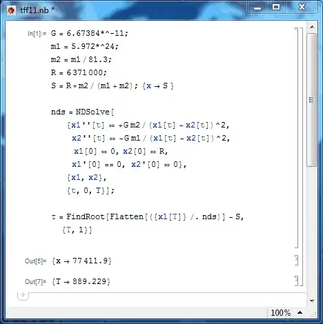

Those are the analytical solutions. If you want to solve it differentially you need to go numeric. In the following example you have 2 point masses separated by a distance of 6371 km, one the mass of the earth and the other the mass of the moon. They will meet in 889 sec and the heavy mass will move x = 77 km in the right, and the light one R-x in the left direction. If you want to solve for velocity or acceleration at time t just replace x1[t] by x2'[t] or x1''[t]:
solution
