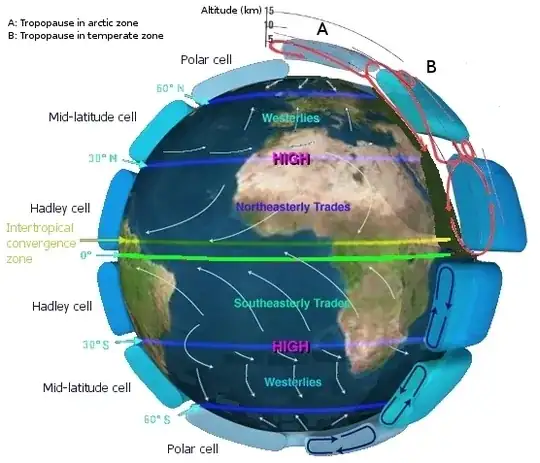

Here is an example of what they look like (source):
There are two bands along each side of the equator. Another set of bands starts 30 degrees north and south of the equator. And another band starts 30 degrees further north and south (at 60 degrees total).
You'll also note that these differences in wind in the same direction of rotation also causes wind to form in the north-south direction. All of this is what drives the major weather systems.

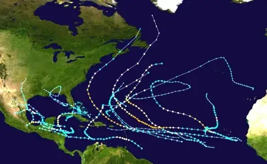

Consider the US. Weather systems will typically move from west to east. Atlantic hurricanes form in the tropical band off the coast of Africa. They form here because the wind is relatively calm and there is little north/south shearing. They then move westward in the tropical band while also moving north due to the Coriolis forces. As they move north, they begin to encounter the westerly winds that are characteristic of the mid-latitude cell. This will eventually turn them around so they move north-east along the US coastline until turning due-east and moving towards Europe (which in turn induces a southward drift due to Coriolis forces).
Here are what several of these hurricane paths look like (source):
