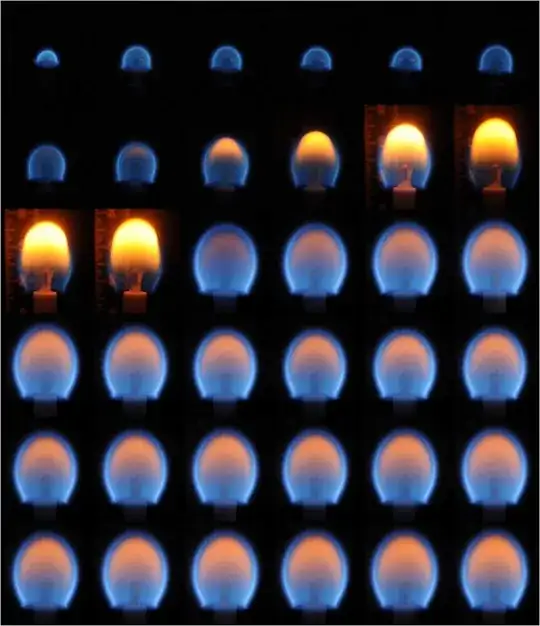

I don't have the studies to do a discursive rendering of the chemical energetics, but you can see from this spectrum that most plasmas have fuel sources that are nearly-inexhaustible by comparison. Terrestrial flames have a very tight length-scales (relative to humans) before the dynamics become unsuitable (in terms of electrons per $cm^3$) to sustaining a plasma reaction — which produces the higher-energetic blues you see at the base of the flame.
You can see this more clearly when looking at a candle flame burning in space. The absence of gravity allows convection to very-evenly mix the soot and other combustibles, leading to a very clean plasma.
candle in space
