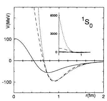

The real repulsive force between neutrons is caused by the repulsive core of the nuclear force - the residual component of the strong force. This force does not depend on nucleon isospin, but does depend on particle spin. As far as I understand it the force does not have a simple radial dependence and it is not spherically symmetric either. The "range" of the force is governed (in models) by the exchange of virtual particles and is of order $10^{-15}$ m. Experimentally the force between neutrons becomes strongly repulsive closer than about $7\times10^{-16}$ m and should (or might) be understood in terms of the Pauli exclusion principle acting at the quark level.
I do not think there is any simple analytical model for the nuclear potential, just approximations. Many of these look a bit like the Lennard-Jones potential between atoms in molecules. Here is one (from http://www.vanderbilt.edu/AnS/physics/volker/p330b/add_lecture_materials/phase_shift/nn_scattering.html ) deduced empirically from scattering experiments; the n-n curve is the dotted one, for anti-aligned neutron spins (i.e. not affected by the PEP). You can see that the gradient becomes very steep and negative (repulsive) at small separations, despite the fact that the neutrons are not in the same quantum state.
Nucleon-nucleon potential
