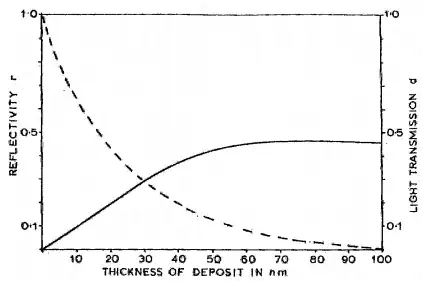

Gold has a relative density of 19.3, so 1g of gold has a volume of about $5 \times 10^{-8}$m$^3$. If you spread this out in a film of 50m$^2$ then the thickness of the film is about 10nm.
The point is whether this is thin enough for light to pass through. If the film is too thick for any transmitted light to penetrate then it should just look gold. If the film has such a high transmission that all light gets through then in transmitted light it won't have any particular colour. For the film to look blue it must allow significant blue light through but block yellow light.
Annoyingly my Googling failed to find values for the optical absorptance of gold. Or rather no freely available data - there are lots of papers behind paywalls. However I did find this graph of the optical transmission at 497nm (blue green light):
Optical transmission
The dashed line is the transmission, and from the graph a 10nm film has an optical transmission of a shade under 70%. That looks just right to make the film look blue green in transmitted light.
