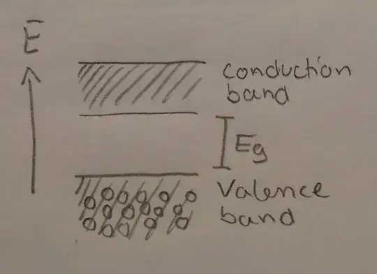

In addition to the other answers, here is a view on the atomic level.
In the molecules of air, the atoms making up the molecules have valence electrons that bind together to form the molecules. The outer shell is initially not full of electrons but will be full when such atoms "share" electrons.
Electrons can have different energy levels - or energy states. Many very close states make up a band. The band where the valence electrons are, when they are bound in the molecule, is called the valence band.
This band is full. No spaces for more electrons. (The exclusion principle forbids two electrons to occupy the same state, so since all states have an electron, the band is full). No electrons can move from one state to another within this band, since no states are empty. (The exclusion principle also explains why usually only the outer shell is important in reactions - the inner shells are full already.)
Now, if one electron can jump up in energy level - all the way up to another band - then in this new band, all the other states are free and unoccupied. This electron can move almost freely around from state to state within this band, and almost no force or energy is needed to move it around. This band is called the conduction band.
If there are electrons in the conduction band, this material can conduct current.
  • Very good conductors have a conduction band and a valence band that almost overlaps.
  • Very good insulators have bands far from each other - there is a large band gap in between.
For electrons to move up to the conduction band in an insulating material, they need to be added enough energy equal to the band gap $E_g$ to move up there. As far as I remember, the energy gap is at about $5 \:\mathrm{eV}$ for a usual insulator to move one electron up there. This is a large amount of energy, that only rarely is applied; e.g. in a thunderstorm where huge potential differences are created.
Then electrons are moved up and "freed" from their fixed positions with the atom. The atoms are now ionized. Then lightning can happen in an insulator like air that suddenly becomes conducting.
