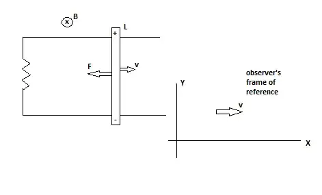

Consider a conducting rod of length $L$ moving with speed $v$ in a magnetic field of intensity $B$. Let all the three parameters be perpendicular to each other. Moving charges in a magnetic field experience a force, which will be in the downward direction in this case. This will cause the electrons to accumulate towards lower end of the rod, thus causing a difference in potential. We know that the emf induced in the rod will be $E=BLv$ or $\vec E=\vec B.(\vec L\;\mathrm x\; \vec v)$ to be more precise. Thus, a current is induced in the rod. A current carrying conductor placed in a magnetic field experiences a force, whose magnitude is given by $F=IlB$ in the direction opposite to that of the velocity of the rod.
Now, consider an observer moving with the same velocity as that of the rod. For him, the charges are stationary. Yet, the rod experiences a force. Now, as far as I know, the only thing that can cause a force on stationary charges is an electric field. So, for him, there must exist an electric field in the direction same as that of velocity of rod, which is causing the electrons to experience a force in the opposite direction (electrons are negatively charged, so force will be in the opposite direction to that of electric feld).
So, does a moving magnetic field produce an electric field?
