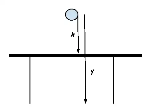

Potential energy is the amount of energy stored in an object with respect to a particular reference point. For instance, look at the image of a sphere above a table below:
We could define the potential of the sphere with respect to the table, $P=mgh$, or with respect to the ground, $P=mgy$. Clearly the potential of the two positions are different, so does that mean the mass is different? The mass should not be different simply by changing your reference point, so the mass is the same. Potential energy only matters due to the change from the reference point.
Consider also the proper definition of Einstein's mass-energy relation: $$ p^\mu p_\mu=E^2-p^2=m^2 $$ (using $c=1$ units). However, this is for a free particle; one that has no potential. When encountering potentials, the energy relation becomes $$ \left(E-U\right)^2=\left(\mathbf p-\mathbf Q\right)^2+m^2 $$ (also in $c=1$ units) where $U$ is the potential energy and $\mathbf Q$ is the potential momentum such that the four-potential is $Q^\mu=(U,\mathbf Q)$. I have not done the math, but I would presume that this fixes your error.
