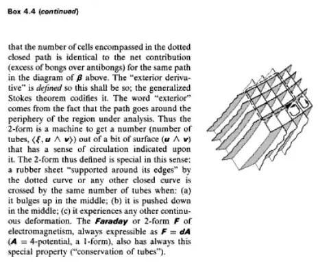

From a geometric perspective, and keeping in mind the duality between (1, 2, 3...) -forms and (1, 2, 3 ...) -vectors, observe that a one-form (rank 1 co-variant tensor) can be pictured as a series of surfaces that produces a number when contracted with a vector; the number being the number of surfaces pierced by the vector.
Generalizing to higher ranks, a two-form can be pictured as a 'honeycomb' like structure that produces a number when contracted with a surface with a sense of circulation; the number being the number of tubes piercing the surface.
A three-form can be pictured as an 'egg-crate' like structure that produces a number when contracted with a volume; the number being the number of cells within the volume.
This is essentially laid out on pages 115 - 117 of MTWs "Gravitation". For example:
