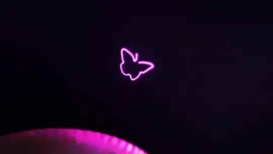

Optical Tweezers/Optical traps.
Screenshot of a optical trap being used to make a hologram Source of image: https://www.youtube.com/watch?v=N12i_FaHvOU
Technically they use smoke, but not a continuous jet of smoke.
Essentially, they can trap particles with a laser beam, and that particle can reflect light. But it can also move said particle in the air in order to make the illusion of shapes to our eyes.
In the video they use a laser invisible to the human eye to keep the particles afloat and then a visible laser beam illuminating the particle in order to make the image.
In the video they are using glass protection for the laser, but maybe they could find a way of not requiring intense lasers like that.
