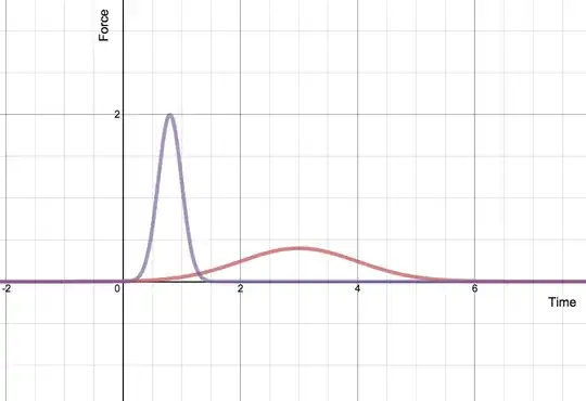

This graph illustrates the force your phone would experience over time if it hit the ground (purple curve) or if it hit your shoe (red curve). The momentum change is the same in both cases - that is, if you integrate (add up) all the momentum that the force gives the phone in each case, you get the same momentum change - the phone comes to a stop.
However, in the case where it hits the ground, the ground is, as you said, much less flexible than your shoe, so the ground delivers a very large force, stopping the phone in a tiny period of time. This large force is what shatters your screen. In the case of the shoe, your shoe is nice and soft, so it delivers a smaller force, stopping the phone over a longer period of time. In fact, if you move your foot downward as the phone hits your shoe (known as "trapping" in soccer), you can stretch out that period of time over which the phone comes to a stop even longer, making the maximum force even smaller.
Since the maximum force in the shoe impact is much smaller than the maximum force in the ground impact, the phone is more likely to break if it hits the ground rather than your shoe.

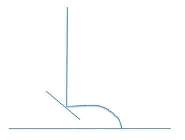

The "shoe" doesn't have to be soft for this to work. Look at the following diagram:
Here, I replace the shoe with a tilted plane. The normal velocity of the phone with respect to this plane is smaller (by $\sqrt{2}$ if the plane is at 45°) and so the force of the impact will be reduced - even if the shoe is made of the same material as the floor. If the impact was elastic, the vertical momentum would indeed be transferred to horizontal momentum, and the final vertical velocity with which the phone hits the ground is equivalent to the drop from the height of the kick.
The same effect would be achieved if you had a less angled plane moving at sufficient velocity - but it would result in greater impact force (unless the plane / shoe was softer).

You can of course try to "catch" the phone on your foot, counting on the relative softness of the foot/shoe to cushion the blow, but to the extent that you can do anything to reduce the vertical velocity you will indeed improve the chances that it survives the impact. The "outrageous" statement has some truth in it. It is possible to transfer vertical momentum to horizontal momentum, and doing so with the simple tilted plane reduces the maximum force of the impact.
