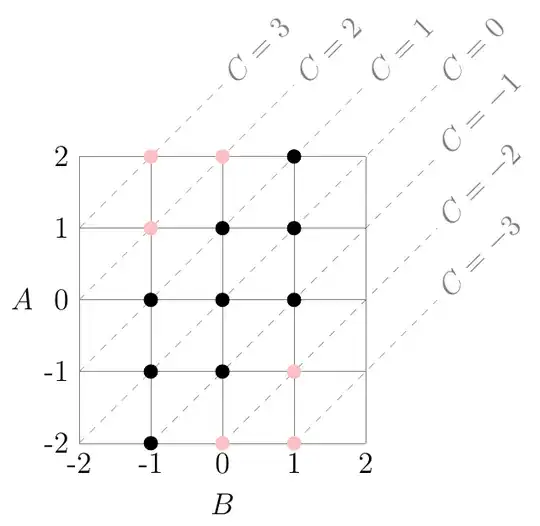

If you used the formula for uncorrelated errors, it would assume that regardless of the value of $A$, the value of $B$ could be anything in the range $-1$ to $1$. If that were the case, you would get cases like $A = -2$ and $B = 1$, which would give you $C = -3$ - that's where the uncertainty range of $3$ comes from. But in reality, there is no case in which $A = -2$ and $B = 1$. That's why the uncorrelated error formula doesn't work. In the following list, all the pink rows are cases that the uncorrelated error formula is taking into consideration, but which can't really happen:
$$\require{color} \begin{align} A &= -2 & B &= -1 & C &= -1 \\ \color{pink}A &\color{pink}= -2 & \color{pink}B &\color{pink}= 0 & \color{pink}C &\color{pink}= -2 \\ \color{pink}A &\color{pink}= -2 & \color{pink}B &\color{pink}= 1 & \color{pink}C &\color{pink}= -3 \\ A &= -1 & B &= -1 & C &= 0 \\ A &= -1 & B &= 0 & C &= -1 \\ \color{pink}A &\color{pink}= -1 & \color{pink}B &\color{pink}= 1 & \color{pink}C &\color{pink}= -2 \\ A &= 0 & B &= -1 & C &= 1 \\ A &= 0 & B &= 0 & C &= 0 \\ A &= 0 & B &= 1 & C &= -1 \\ \color{pink}A &\color{pink}= 1 & \color{pink}B &\color{pink}= -1 & \color{pink}C &\color{pink}= 2 \\ A &= 1 & B &= 0 & C &= 1 \\ A &= 1 & B &= 1 & C &= 0\\ \color{pink}A &\color{pink}= 2 & \color{pink}B &\color{pink}= -1 & \color{pink}C &\color{pink}= 3 \\ \color{pink}A &\color{pink}= 2 & \color{pink}B &\color{pink}= 0 & \color{pink}C &\color{pink}= 2 \\ A &= 2 & B &= 1 & C &= 1 \end{align}$$
You can also envision this graphically, by plotting $A$ against $B$. The colors of the dots correspond to the colors in the table above: black dots are the points that can really happen, while pink dots are the points that can't really happen but that are (wrongly) incorporated into the uncorrelated error formula.

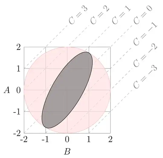

This plot is a discrete version of something you'll see in a lot of scientific papers. When you don't have the requirement that the variables be integers, then instead of discrete points, you'll get a smooth region, but it's basically the same idea.
continuous correlation plot
In this plot, the gray ellipse shows the most likely values for $A$ and $B$ to have, in some hypothetical experiment. The fact that it's a slanted ellipse shows that $A$ and $B$ are correlated. If they weren't correlated, the shape would be a circle, like the pink one, or perhaps an ellipse where the long axis points straight vertically or horizontally. (The reason why it'd be an ellipse instead of a rectangle has to do with probability distributions; that's more than I can get into here.)

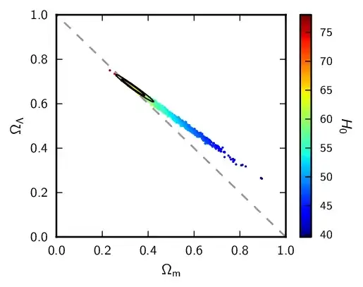

For the fun of it, here is an example of correlated uncertainties from the Planck collaboration's paper on cosmological parameters:
correlation graph of matter and dark energy density
This plot shows the correlation between the possible values of the dark energy density and the matter density in the universe. Even though the dark energy density $\Omega_\Lambda$ and the matter density $\Omega_m$ could each individually take on a range of different values, the sum of the two, which represents the total energy density, is known to be very close to $1$ (the diagonal line), which is only possible because the scientists knew to look for this kind of correlation in the uncertainties.
