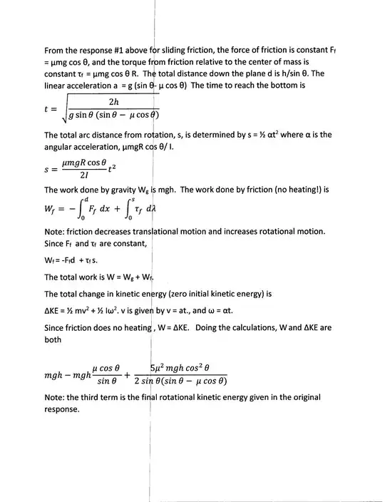

I have not seen a good treatment of work from friction in the earlier responses to this question nor in responses to other related questions. For a rigid body, there is no heating effect from friction. Consider the work done from sliding friction. (Rolling friction does no work since there is no sliding of the body; similar to a fluid flowing in a rough pipe with no slip at the pipe surface; the friction force at the pipe surface does no work on the fluid.) For example, numerous past questions and responses address the effect of sliding friction for rotational motion in a plane, but incorrectly address the heating effect from friction. Here are three: [text]https://physics.stackexchange.com/questions/165453/tricky-conceptual-question-ball-sliding-and-rolling-down-incline?r=SearchResults&s=1|99.3755 (1)
[text]https://physics.stackexchange.com/questions/527671/does-friction-do-work-or-dissipate-heat?r=SearchResults&s=2|48.8239 (2) [text]https://physics.stackexchange.com/questions/571004/work-done-by-friction-on-a-sphere-sliding-down-the-inclined-plane?r=SearchResults&s=26|31.0922 (3) The responses evaluate torque as inertia times angular acceleration. Then the responses indicate that friction causes heating. Heating does occur in reality, however the relationship torque = inertia times angular acceleration implicitly assumes a rigid body and for a rigid body there is no internal dissipation of energy (no heating). For a rigid body friction only changes the kinetic energy of the body. Consider question/response #1 above for the case of sliding friction. The response nicely evaluates the dynamics of the motion, but then says “when the sphere starts slipping, you lose energy, … energy is lost in heat.” This is not correct; since the response implicitly assume a rigid body, the effect of friction is only to change the kinetic energy of the object. The initial kinetic energy of the object is zero. The final kinetic energy of the object is its translational kinetic energy plus its rotational kinetic energy. It can be shown (see below) that the total work done by gravity and by friction is equal to the change in kinetic energy. The point is that evaluations that implicitly assume a rigid body and then state friction causes heating are incorrect. To address heating effects, the rigid body constraint should be removed and the first law of thermodynamics applied. For the question response 1 above for sliding friction, the following calculation shows that work from gravity and friction = change in kinetic energy of the object.
Does anyone have a relatively simple approach for evaluating the heating for a solid non-rigid body? For example, in fluid mechanics the mechanical energy equation sometimes includes a friction loss term to approximate the energy loss that would be accurately evaluated using the first law of thermodynamics and conservation of mass and momentum.
