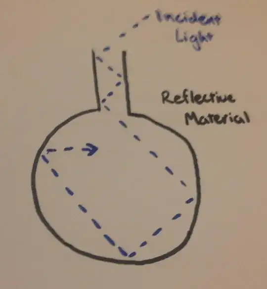

For a given container made of an extremely reflective surface, is it possible to shine a beam of light in, and with no 'fiddling' (i.e. closing the hole, tilting the object) to contain the beam for an infinite amount of time (not a very long time, but such that it will never escape). Consider the following
here
Something like this. Except I feel like the light will escape given enough time. Also, the object has to be finite in size (infinite is cheating). If there's a proof that no such container exists then that's fine too.
Ignore factors such as dissipation by heat, or quantum tunneling, and just assume a perfect environment with perfect materials.

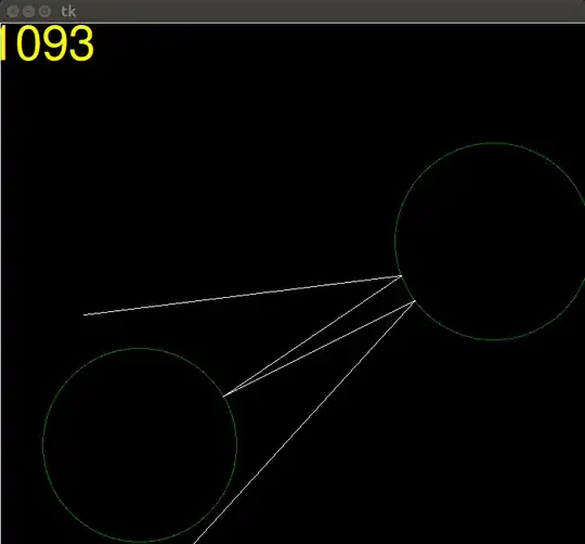

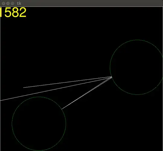

With classical ray optics, yes. For example, it is possible to trap a ray between two reflecting spheres. Here are two pictures I created with one of my old computer programs (actually this was a teamwork project).
On these two pictures, the incident ray was directed at slightly different angles. It is quite clear, that there exists some limiting case between these two angles, in which the light will not escape either downwards nor upwards. Obviously, we could also use such a system in a bottle.
However, it should be noted that the path of the ray is unstable. If we had taken account also wave-optics, the wave would have "leaked" away very fast from he unstable equilibrium. It turns out, that taking into account quantum mechanics, such a system could be used to heat a hotter body (inside to bottle) with a colder body (outside), which is a contradiction. Thus in real life, this is impossible.
