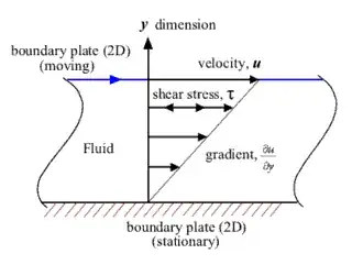

Encountering a lot of issues trying to understand this. The basic idea of the derivation I'm using is as follows (the image here may help):
(source: tamu.edu)
I'm going to write $\langle u_x\rangle$ as the general horizontal speed instead of $u$ and save $u$ as the horizontal speed of the top plate.
So the idea is that we have our gas between two plates, the top one moving at constant speed $u$ and the bottom one fixed. Now this apparently means that we should get a transport of momentum through the gas, from the top plate down towards the bottom plate. However, how can this be? If you look at the gas as a whole, it is in a steady state, in that each layer is moving at a constant speed due to whatever velocity gradient $$\frac{d\langle u_x\rangle}{dy}$$ exists. Therefore, how is momentum being transported throughout the gas - if this were the case, surely layers would be changing their horizontal speeds and so we wouldn't have this steady state.
The gas is in a steady state, and momentum is being transferred. This means that a steady horizontal force on the top plate is required, and an equal and opposite force on the bottom plate. Each layer of gas receives momentum from above, and transfers the same momentum to the layer below it, so it undergoes no acceleration.
$F/A$ represents the change in momentum in unit time of unit area of this layer
The layer has a steady speed, so it has no change in momentum per unit time. $F/A$ is the momentum transferred from one layer to the one below it.
