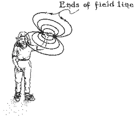

The following passage has been extracted from the book "Black Holes and Time Warps, Einsteins Outrageous Legacy" by Thorne:
If one expressed Maxwell's eletromagnetic laws in terms of the electric and magnetic fields measured at rest in absolute space, the laws took on an especially simple and beautiful mathematical form. For example, one of the laws said, simply, "As seen by anyone at rest in absolute space magnetic field lines have no ends". However, if one expressed Maxwell's laws in terms of the slightly different fields measured by a moving person, then the laws looked far more complicated and ugly. In particular, the "no ends'' law became, "As seen by someone in motion, most magnetic field lines are endless, but a few get cut by the motion, thereby acquiring ends. Moreover, when the moving person shakes the magnet, new field lines get cut, then heal, then get cut again, then reheal". The new mathematical discovery by Lorentz, Poincare, and Larmor was a war to make the moving person's electromagnetic laws look beautiful, and in fact look identical to the laws used by a person at rest in absolute space: "Magnetic field lines never end, under any circumstances whatsoever." One could make the laws take on this beautiful form by pretending, contrary to Newtonian precepts, that all moving objects get contracted along their direction of motion by precisely the amount that Fitzgerald needed to explain the Michelson-Morley experiment!
As I understand, if magnetic lines had ends, then there should exist monopoles, which we don't believe to exist. If length contraction is not included, there will be open ends. Here arises the test of validity.
