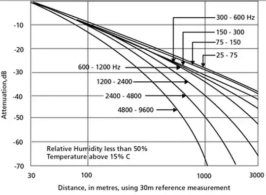

2 - propagation of sound Like all finite-sized sources of energy, once you are a reasonable distance (reasonable compared to the size of the object generating the sound) away, sound intensity falls off as the inverse square of the distance (barring mechanisms to contain the direction of propagation: tunnels, mountains etc). This means that sound will typically remain audible for roughly the same distance as the object making it remains visible/interesting. Certain very loud sources (e.g. crickets) are an exception to this rule - but they are deliberately trying to be heard a long way off (see point 4). Sound is also attenuated by air - according to Stokes's Law, the attenuation coefficient $\alpha \propto \omega^2$, meaning that higher frequencies are absorbed more strongly (because of viscous interactions in the air). From the Bruell & Kjaer website:
Low frequencies really only get attenuated according to the inverse square law, but higher frequencies are attenuated more strongly.
