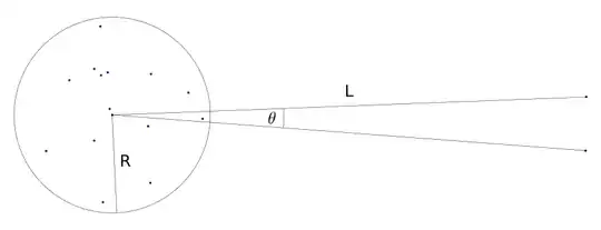

Suppose we illuminate the fractal with a monochromatic light. The solution to Maxwell's equations is the superposition of the illuminating light wave and the contribution of each little point on the fractal that interacts with the wave. Only these little points contribute to the resulting refracted/reflected light. I model the result by assuming a collection of $N \gg 1$ points, confined in a region with a radius of approximately $R \gg \lambda$. The observer is looking from some distance $L \gg R$.
Illustration of the model
The complex electric field (ignoring the phase shifting in time) is mathematically $$E_{direction} \propto \sum\limits_{p} k_p e^{i2 \pi x_p / \lambda}$$ where $k_p$ is some complex constant describing the amplitude and phase of the generated field of some point $p$ and $x_p$ is the distance to that point. The term due to field falloff with distance is in the proportionality constant.
