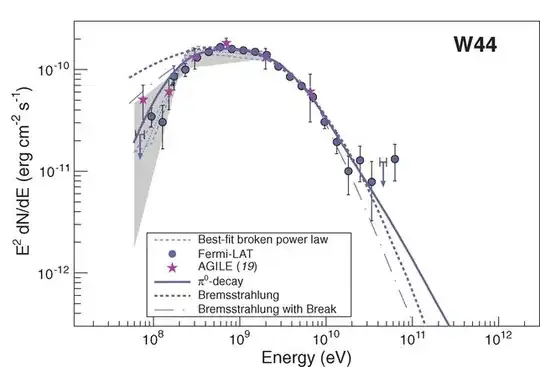

It is more likely that the non-detection would be associated with statistics than SNR's not accelerating protons. Fermi-LAT has already shown that $\gamma$-ray emissions from 4 galactic supernova remnants (with molecular clouds nearby them) are coming from proton-proton collisions leading to neutral pions ($pp\to pp\pi^0$, $\pi^0\to2\gamma$):
(source, arxiv link)
