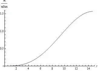

Directly from my thesis, I can show you the (non particularly spectacular) functions $m(r)$ and $p(r)$ inside the star.
mass
In the horizontal axis you can see the $r$ coordinate in $Km$. In the vertical one the ratio $m(r)/M_{SUN}$. The function m(r) is roughly speaking the mass inside a sphere of radius $r$, so the value $m(R)$ is the mass that you can measure from outside. The radius of the star is determined with the pressure graph:

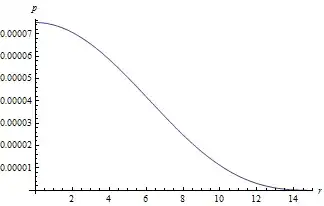

pressure
When the pressure goes to zero it means that we have reached the surface of the star. So in this case, the star as a radius of $\simeq 14 Km$ and is mass is $\simeq 1.5 M_{SUN}$. (every star is uniquely identified by his pressure, or equivalently his energy density, at the center of the star).

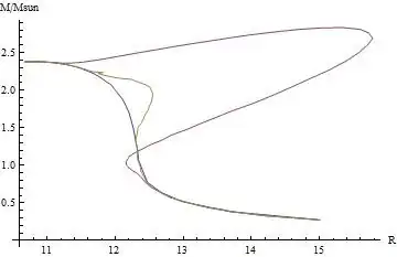

To be more explicit, here there is a parametric graph of the mass and the radius of the star when we change the central pressure. Every point in the graph is a stable stellar configuration predicted by GR (the blue line). The yellow and purple line are predictions from some scalar tensor theories of gravity (possible alternative theories to GR).
For example, an immediate prediction is that the maximum value of the mass for a neutron star is below $2.5 M/M_{SUN}$. (of course the precise value depend on the EOS you use). This is absolutely confirmed by experimental data.
