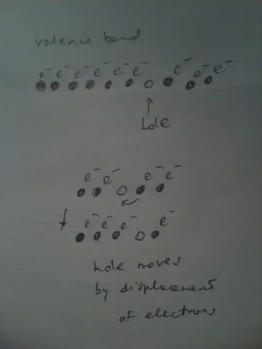

Here's a sketch:
Hopefully from this you can appreciate that the hole can only "exist" and "move" when there are several electrons around, but it could not do it on its own.
