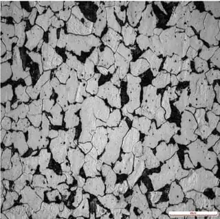

To give you a specific example, consider steel: steel is an iron-carbon alloy. At a large enough scale (let's say the mm scale), steel is homogeneous. However, if you look at it close enough ($\mu$m scale), this is what you see (source):

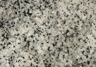

Definitely not homogeneous. Another example is granite:
Other examples of materials which are homogenous/isotropic on large scales but inhomogeneous/anisotropic on smaller scales, apart from alloys, are polycrystalline materials.

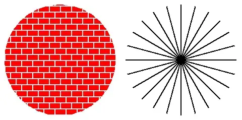

To conclude, I will just remark that homogeneity and isotropy are independent from each other. Below you can see an homogeneous but not isotropic pattern on the left and an isotropic but not homogeneous pattern on the right (source).
Edit: I should have specified this, but a material can be isotropic with respect to a point. The figure on the right is isotropic with respect to its center, however it is clearly not isotropic with respect to all points. If it was isotropic with respect to more than 1 point, it would also be homogeneous.
