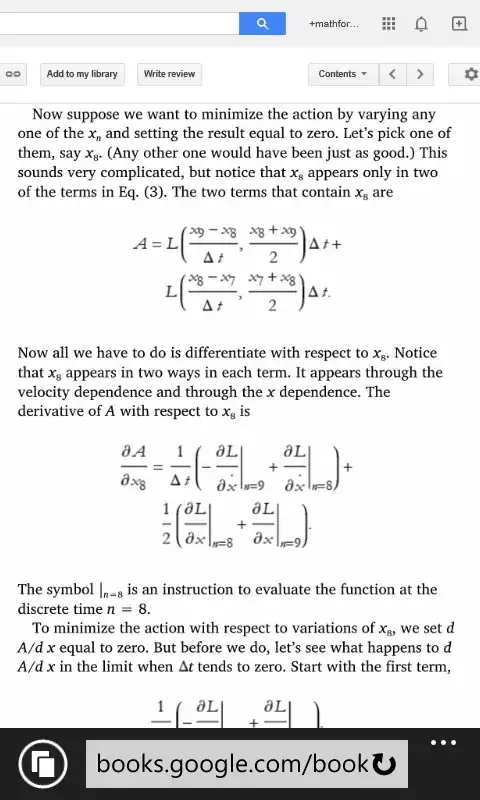

First, I believe there is a trivial error. The second equation should have another $\Delta t$ multiplying everything on the right. It is divided out later when the equation I set equal to 0.
  1. Given that $L$ is a function of $ x_7, x_8, x_9$ how can he justify evaluating it at single points?
  2. Also, why are points 8 and 9 used rather than 7 and 8?
For context, this is the last equation on page 112 and the first equation on page 113 of Susskind's The Theoretical Minimum.

Yes, I agree it looks like the second equation is missing an overall factor of $\Delta t$ on the right.
The action is a function of all the $x$s for the whole trajectory, but the Lagrangian is not. It is only a function of a position and a velocity. So it makes perfect sense to evaluate it using the position and velocity for a single time.
Points 8 and 9 are used because (I guess) the action is defined as a sum of terms involving $x_n$ and $x_{n-1}$, so the terms that involve $x_8$ are the 8th and 9th terms. If he had defined the action using $x_n$ and $x_{n+1}$ then he would have had to take the 7th and 8th terms instead. It's just a choice of convention.

In order to add more context to anyone else that stumbles upon this, in the book directly above the screenshot posted, the author defines the action as follows: $$A = \sum_{n} L\left(\frac{{x_{n+1}} - x_n}{\Delta t},\frac{{x_n} + x_{n+1}}{2}\right)\Delta t.$$
I agree with the accepted answer that a factor of $\Delta t$ is missing on the right.
According to the convention chosen by the author, I believe that the 7th and 8th points should have been used for evaluation.

I still think it might be wrong. the 8th term is dependant on x8 and x9 and the 7th term is dependant on x7 and x8. Therefore L should be evaluated at n=8 and n= 7.
