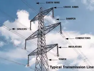

Below is a picture of a typical transmission line(about 200 kV). Is there a simple physics experiment which can be performed safely near the line, to determine the power flow direction. Or in other words: where is the generator and where a consumer.
