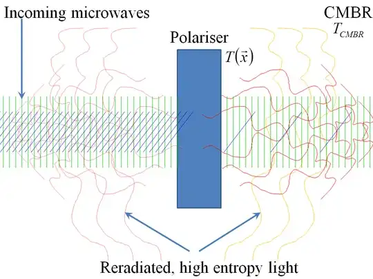

Let's imagine a finite-length, depolarised beam of microwaves moving through deep space. All quantum state variables - direction, spin, frequency - aside from polarisation set to known states so the light is fully describable by a $2\times 2$ density matrix written with respect to the polarisation eigenstate basis. The photons don't need to be in frequency (energy) eigenstates and direction (momentum) eigenstates, but instead can be a quantum superposition of such eigenstates (not a mixture), so that they form a pulse can be finite in space and time. The photon ensemble is moving through deep space separated from its source so that we can think of the whole initial system as:
  1. The microwave photon ensemble, described by a classical mixture of two pure states (quantum superposition of energy and momentum eigenstates) that differ only by being in orthogonal polarisation states;
  2. The freespace quantum light field, in thermodynamic equilibrium at the CMBR temperature of $T_{CMBR}=2.7K$, so it is a mixture of thermalised photons described by the Planckian BB spectrum at $T_{CMBR}$;
  3. The polariser itself, also initially at thermodynamic equilibrium at $T_{CMBR}$.
It should be pointed out that depolarised microwaves whose other quantum properties are otherwise perfectly known are exotic creatures and I cannot think of how one might produce such things experimentally, contrasting with the situation for light where such mixtures are much more plausible. Nonetheless, there doesn't seem to be any in principle reason why such mixtures can't exist for microwaves if they do for visible light.
We consider the pulse sundered from its source, so we have already accounted for the entropy increase in the production of the light, which, as Wolphram jonny's Answer points out, will produce a great deal of entropy. There is no problem with the second law here. But we now wish to know what the entropy changes are for the system that begins as incoming microwave energy, polariser and CMBR.
As By Symmetry's Answer discusses, initially the polariser is not at equilibrium and heating is irreversible. It will begin to heat up. But it must eventually reach a steady state: it may have temperature gradients in it with a "hot spot" where the beam is absorbed, but it will eventually be described as a temperature distribution $T(\vec{x})$. This steady state is reached when the sum of the incoming power from the beam together with the heat absorbed by the polariser from the CMBR equals the heat re-radiated to the CMBR radiation field in unit time. I sketch these ideas below.

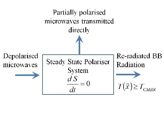

Steady State System
At steady state, the polariser's macrostate is unchanging with time, therefore its total entropy must be steady. We can therefore think conceptually of the conversion happening as the light is absorbed by the polariser and, later, the equal nett power is radiated to the CMBR field as drawn in my sketch below:
Conversion of Microwaves
At steady state, therefore, we need to account for:
  1. The entropy lost from the beam through any polarisation: the entropy of the partially polarised beam output less that of the input beam;
  2. The entropy increase of the radiation field as the energy input to the polariser from the beam is re-radiated.
