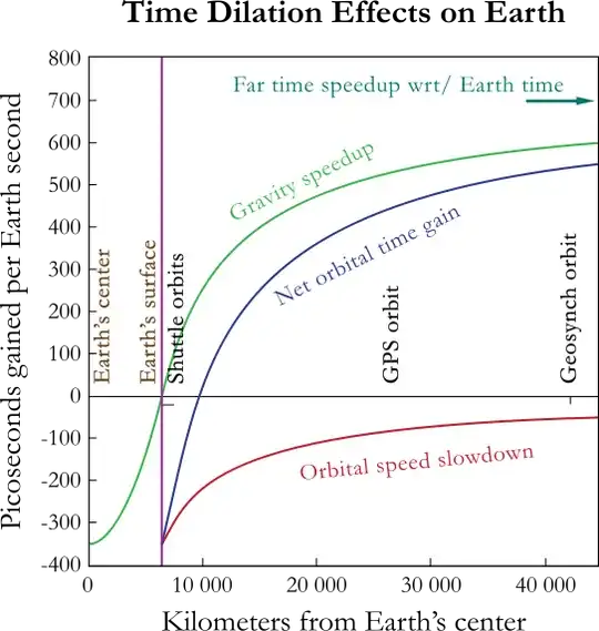

Note the image below: Spaceships in orbit slow down due to moving fast, but speed up due to being higher up in Earth's Gravity well, with the net effect being a speedup at normal orbital speeds.
Time Dilation Effects Near Earth in Orbit
