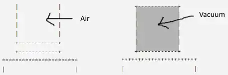

Let's say we have two identical boxes (A and B) on Earth, both capable of holding a vacuum and withstanding 1 atm outside acting upon them.
A is holding a vacuum, while B is filled with air (at 1 atm). Shouldn't they weigh the same as measured by a scale?
Current thought process
The following thought experiment suggests they'd have the same weight, but I haven't formulaically shown this — and everyone has disagreed so far.
Take a box like B (so it's full of 1 atm air) and place it on a scale. Here's a cross section:
    |            |   <-- B box
|                     |    <-- scale
Now, taking note of the scale readings, start gradually pushing down the top "side" (rectangle/square) of the box (assume the air can somehow escape out of the box as we push down)
Then
etc., until the top side is touching the bottom of the box (so the box no longer has any air between the top and bottom sides):
It seems to me that:
1) pushing the top of the box down wouldn't change the weight measured by the scale.
2) the state above (where the top touches the bottom) is equivalent to having a box like A (just a box holding a vacuum).
Which is how I arrived to my conclusions that they should weigh the same.
What am I missing, if anything? What's a simple-ish way to model this?

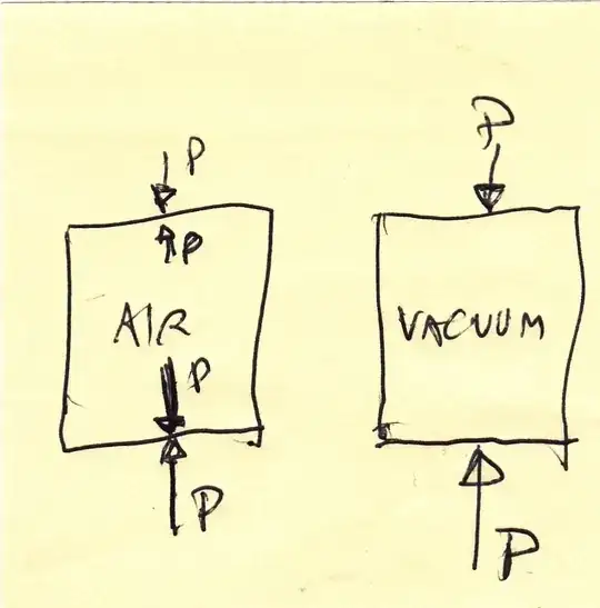

Here's a way to think about it that avoids assuming the bouyant force equation is correct. All you need to know is that air pressure increases with depth / decreases with height.
First off, before we put anything at all on our scale, there's already a large force pushing down on the scale's plate.
$$F_0 = P_0 A_\mathrm{plate}$$
This force gets cancelled out while calibrating the scale, so we don't typically count it toward the weight of anything.
Now let's put a box full of air on the scale. Assume it has area $A_\mathrm{box} < A_\mathrm{scale}$ on the top and bottom, vertical sides, and thin faces, and total mass $m_\mathrm{box}$. At the top of the box, air pressure is a little bit less by a difference given by the density of air times the local gravitational acceleration times the height of the box, $P_\mathrm{top} = P_0 - \rho g h$. So the vertical forces acting on the box are:
  • $-m_\mathrm{box} g$, downward from gravity
  • $-P_0 A_\mathrm{box}$, downward from inside air pushing on the bottom
  • $+(P_0-\rho g h) A_\mathrm{box}$, upward from inside air pushing on the top
  • $-(P_0-\rho g h) A_\mathrm{box}$, downward from outside air pushing on the top
  • $+F_\mathrm{contact}$, the upward force from the plate scale.
Since the box is not moving,
$$F_\mathrm{contact} = m_\mathrm{box}g + P_0 A_\mathrm{box}.$$
The plate still has some air pressure pushing down on the remaining area, so the total forces downward on the plate are
$$F_\mathrm{total} = P_0 (A_\mathrm{plate} - A_\mathrm{box}) + F_\mathrm{contact}.$$
The weight reading is the difference
$$F_\mathrm{total} - F_0 = m_\mathrm{box} g.$$
(Luckily for most scale applications, air inside a container ends up cancelling out.)
Next let's put the identical box full of vacuum on the scale. The forces from air inside the box disappear, leaving:
Again, the box is not moving when we read the weight, so this time the force between the scale and box is
$$ F_\mathrm{contact} = m_\mathrm{box} g + (P_0-\rho g h) A_\mathrm{box}. $$
We still have
$$F_\mathrm{total} = P_0 (A_\mathrm{plate} - A_\mathrm{box}) + F_\mathrm{contact},$$
So this time
$$F_\mathrm{total} - F_0 = m_\mathrm{box} g - \rho g h A_\mathrm{box}.$$
The airless box results in a lower scale reading, and the difference is exactly the bouyant force $\rho g V_\mathrm{box}$.

The vacuum-filled (i.e. evacuated) box A has the same weight as the "squashed" box, but larger volume: and hence has a lower total weight as measured by the scale.
The key thing you're forgetting is that the atmosphere also has a vertical pressure gradient, much like any body of water. This means that, if you take your box with the lid pressed down,
         (*)                                         (*)            z=h
    |            |   <-- B box         |        |   (**)     |      z=0
|                     |    <-- scale   |    |                     |
the pressure on the pressed-down lid at $z=0$ (point (**)) is greater than on the unpressed lid, at $z=h$. As with water, the pressure difference is given by $$\Delta p=\rho g h,$$ so the additional force on the empty box is $$\Delta F=A\Delta p=\rho g h A=\rho V g,$$ which is exactly the weight of the air that's been let in.
