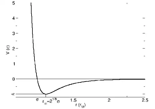

If you graph the total potential energy of these contributions as a function of the atoms' separation, you get something that looks roughly like this:
Lennard-Jones potential graph
(source: wikimedia.org)
Knowing that force is the negative gradient of the potential energy, you can tell that the atoms experience a repulsive force when they are close together and an attractive force when they are further apart. The repulsive force gets larger the closer together the atoms are, essentially without limit, so no matter what force is pushing the atoms together, the system will reach some equilibrium point where the forces are balanced (except under certain extreme conditions that never occur on Earth). This illustrates how atoms are able to resist the forces pushing them together.
