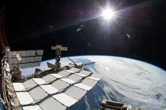

As an example, the International Space Station (ISS) has external thermal radiators. They looks similar to solar panels, but instead of pointing the flat side towards the sun, they point towards empty space. An ammonia loop carries heat from various parts of the space station to the radiators.
This is a picture of a radiator: enter image description here (source)
