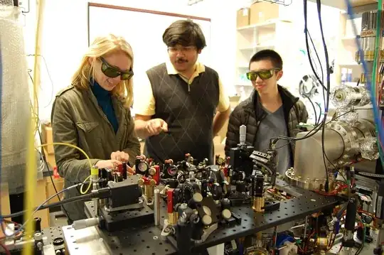

It looks like this experiment is similar to what you're talking about:
Graduate students Airlia Shaffer, Yogesh Patil and Harry Cheung work in the Ultracold Lab of Mukund Vengalattore, assistant professor of physics.
http://news.cornell.edu/stories/2015/10/zeno-effect-verified-atoms-wont-move-while-you-watch
They have a billion atoms of Rubidium, cooled to near absolute zero, "frozen in time" by the Quantum Zeno Effect using a well-timed laser pulse. That's 1.41923×10^-16 kg, according to Wolfram Alpha.
I doubt the experiment scales with a macroscopic sample. But, just say you could do it with lasers, magically, using a similar setup that somehow scales linearly. You'd need 10 quadrillion times the laser energy they've got there. If their experiment uses, say, 1/1000th of a suburban home's electricity, you're looking at using the electricity that would power over a trillion homes, far more electricity than all of the homes on earth.
On the other hand, cryogenics is probably a much more energy-efficient way to "freeze time" for an object, especially a living thing. If you're not trying to keep your sample from undergoing radioactive decay, I'd go cryo!
