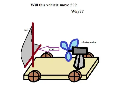

So simple:
Will this sail-based moving system work? Why?
AHB
  • 912
It does work - poorly. The sail has to be large enough, and it takes a very strong fan. You would be be better off turning the fan and using it to propel your boat directly as they do on swamp boats in Louisiana.
Proof: Mythbusters video.
The boat will actually move forwards if you have a strong enough fan and a big enough sail.
Imagine that instead of a sail you put your fan at one end of a pipe. With a straight pipe, you point the pipe off the back of the boat so that the fan blows air through the pipe and out the back (fan in the pipe at the fron of the boat.) This will push your boat forwards.
Now put a 90 degree bend in the pipe. The fan sticks off to the side of the boat, but the boat still moves forwards because the air leaving the end of the pipe moves away from the back of the boat.
Now make a 180 degree bend in the pipe. The boat will still move, as long as the inlet and outlet are far enough apart that the outlet isn't sucked back in the inlet.
The U-shaped pipe is like the sail. It reverses the direction of airflow, and if the flow from the fan and from the sail don't interfere with each other too much, the boat will move.
