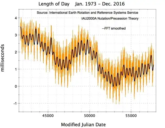

The strict answer:
By definition the day (mean solar day) has 24 hours. Ever.
The statement 'and in doing so makes the days longer' is not supported by the last 44 years or so OF official most precise satelite mesurements .
EDIT ADD:
As can be seen in this official graph the Length of Day as compared to a more constant reference (86400 atomic seconds) is shortening indicated by a downward trend.
The naive mistake we observe in the media is this: One more leap second? Then the LOD is enlarging.
