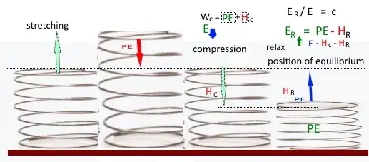

Could you explain in detail how potential energy is actually stored in a steel spring and why the material never surrenders to the bending forces taking a new shape?
Update: it would be interesting if someone might add some technical details:
  • is the quantity of energy transformed into heat during the compression $H_C$ equal to that lost during the release $H_R$
  • is the heat loss during the two phases due to the exactly same causes, process
  • how do you minimize heat loss, one factor is surely the mass, what is the max value of the ratio between energy spent in the compression and the energy retrieved ($c, \gamma$)? I read it can be: $E_R/E > 0.99$
  • what determines the ratio between energy retrieved and velocity of rebound (CR)
  • what is the max CR achieved to date in a spring, and with what material
  • choosing the right material, can the speed of relaxation ever increase with the deflection in such a way to allow an elastic collisions

Your "technical" details are good questions to confirm one's understanding of the subject! Let me try to address them in order but rephrased:
  1. Is the energy transformed into heat during the compression $H_c$ exactly equal to the mechanically lost energy (the bit of the compressive energy not recovered upon release)?
    Your assumption is almost true. The lost energy is lost because it is dissipated (converted into heat). But it is (somewhat theoretically) possible that some of the heat temporarily generated during the compression gets adiabatically converted back into mechanical motion. This occurs for fast motion on not too small length scales (for the speed). It matters for details such as the spectrum of thermally driven, sub-microscopic fluctuations of metal surfaces (yes, there is Brownian motion everywhere).
  2. Is the heat loss during compression and tension due to exactly the same processes?
    Essentially, yes. You basically introduce a minus sign almost everywhere. For example, the adiabatic temperature change (compression heats things, expansion cools things) causes thermal conduction to go the other way but otherwise dissipate in just the same way because most things that matter tend to be linear in temperature change and hence much the same. Obviously there are minor exceptions: To address another quantitatively rather unimportant example, dissipation by thermal radiation is not quite symmetric: When you compress and hence heat, it increases more than it decreases for the same tension and hence cooling. Perhaps more relevant (but further outside my personal expertise), there are probably other heating mechanisms, such as heat released or absorbed in changes of the crystal domains, that could break the symmetry between compression and tension.
  3. How does one minimize the loss of mechanical energy when cycling a spring?
    Using (spring) steel is a good start; especially for very fast cycling (think steel balls bouncing into each other), it has a very high coefficient of restitution. You can do orders of magnitude better by using certain crystals or glasses (fused silica, quartz crytsalls, sapphire, silicon crystalls can reach 0.01 parts-per-million loss when operated in a vacuum). But there are lots of very unconvenient effects especially at surfaces and contact points. Quartz crystals for watches, tiny tuning forks, have Q factors (the inverse of the fractional energy loss per cycle) limited to about ten thousand despite coming in a vacuum package, because of losses at the mechanical mount points and electric contacts. If you open their vacuum package, you risk reducing the Q factor by an order of magnitude simply due to air friction and surface contamination. Must I even mention that glasses and (nonmetallic) crystals tend to have certain disadvantages such as being extremely brittle?
  4. What determines the ratio between energy retrieved and the kinetic energy (squared speed, normalized by spring's effective mass for this purpose) at which the unloaded spring's end rebounds?
    The short answer is that this ratio is one. Please excuse me for simplifying the question by pushing the bit that acts as effective mass of your spring's end (the entire mass weighted by how much is contributes to the total kinetic energy) into the question. The geometry and composition of your spring determines it. It is easy to calculate in principle and hence not very enlightening to consider in detail.
    It is very helpful to consider the process as cyclically repeating. Then you have an oscillation of the same frequency of all relevant quantities, and the ratios between their amplitudes have special names. For example, the ratio between speed and force is called the (mechanical) impedance. An engineer might more naturally base an answer on this impedance than my personal (but accurate) concept of an effective mass for your purpose.
  5. What is the maximum coefficient of restitution?
    I don't know, and I won't accept any one value as it simply depends on what you still accept as a spring. If you consider the "restitution" of sub-microscopic indentations of solid quartz or fused silica test masses for gravitational wave detectors, the lost energy per deformation energy can be less than 0.01 parts per million.
  6. Can there be essentially ellastic collisions?
    Yes. Use steel balls for their springy behavior.
