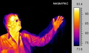

The answer is "not necessarily," as you stated in the question. Here is a neat video of a person's hand visible in IR through a black/opaque plastic bag, and here are some pictures of the same:
visible light bag ir light bag
Image source: NASA/Caltech

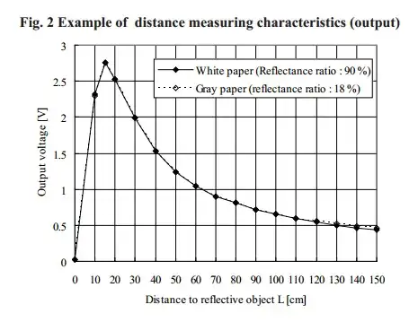

From a typical IR proximity sensor datasheet it indeed appears that there is no difference in ability to sense between reflection of IR off a white piece of paper vs. a gray one:
Voltage vs. Distance

A quick search did not prove very fruitful. Glass is not transparent to IR, as you can see in the man's glasses in the picture above, as well as at 0:20 in this video. However, at 0:52 in the same video you can see that glass does reflect IR to some extent (when the hand is on the same side as the glass). As we've seen, the absorbance of light depends very much on the wavelength, so first you would need to figure out which wavelengths the opponent's IR LED would output. It may be hard to find a common material that absorbs through that entire IR spectrum, so don't forget there are many ways to skin a cat! Alternatives to making your bot out of an IR absorbent material:
