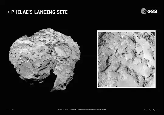

Although your method should yields a good approximation, it is possible to calculate is much easier using the Kepler equation, however the accuracy of this results is up to discussion, since the comet's gravity is far from having spherical symmetry. For a Kepler orbit we do not have enough information, namely the direction of the velocities (radial and lateral components). You assumed complete vertical motion, however I think it would be more likely that at touchdown the lateral velocity would match that of the surface. For this you need to know the position of the landing site and the speed and direction of the rotation of the comet. The landing site is located at the "head" of the smaller of the two lobes of the comet, also called site J and later doped Agilkia:

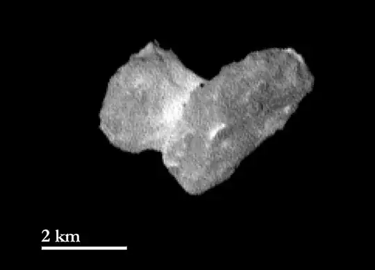

I was not able to find the actual altitude relative to the center of gravity of the comet, so this will have to be estimated. For this I will be using this video showing the center of the comet and the following image to get the scale:
My best estimation from these two sources gives an altitude of about 2.8 km. This landing site is fairly close to the equator, so the surface velocity would be just the altitude times the angular velocity. The angular velocity can be calculated from the rotation period of 12.4043 ± 0.0007 hours and therefore the surface velocity would be equal to about $0.39\ m/s$. From this it can also be derived that the specific angular momentum, $h$, would be equal to $1.1 \times 10^3\ m^2/s$. To be clear the mentioned height of release is measured from the center of the comet. Combining these properties yields an orbital eccentricity of 1.46 and a semi-major axis of -1.6 km. The impact velocity calculated from these orbital elements would be 0.86 m/s (only the radial orbital velocity component, since the lateral component was chosen to be zero relative to the surface). The time between separation and impact would take about 27000 seconds or about 7.4 hours. If I would use a purely vertical descent it would take 7.3 hours. These results are a lot closer to the actual 7 hours (not sure how exact this number is). When considering that the comet is far from spherical and that the release velocity might as well be close to 2.4 or 2.6 km/h, which already changes in travel time to 7.7 or 7.2 hours respectively, I think that this is a reasonable good approximation.
