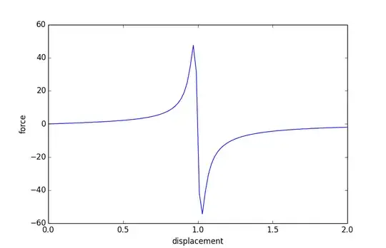

To compute the force on a ring, I drop all constants, set the ring radius to 1 and place the earth at the origin, also I use complex numbers to represent the vectors. The ring is parametrized as $e^{i \varphi}, \varphi \in [0,2 \pi]$, The force on a concentric ring is then given by
$$F = \int_0^{2 \pi} \frac{e^{i \varphi}}{|e^{i \varphi}|^3} d\varphi$$ this is trivial and the solution is zero, now we shift the ring slightly to the right
$$F(\varepsilon) = \int_0^{2 \pi} \frac{\varepsilon + e^{i \varphi}}{|\varepsilon +e^{i \varphi}|^3} d\varphi$$
I imagined this to be not that much harder to solve, but 20 minutes later Maple went up to 400 MB of memory usage and still hasn't produced a result so I evaluated it numerically instead enter image description here
As soon as the ring is displaced, it experiences a force in the same direction which results in further displacement (up to $\varepsilon<1$, then it hits the ground, earlier if the earth has a non-zero radius)
