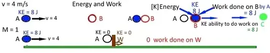

Work is just a hyponim of energy: energy is the potentiality, work is the concrete, actual transfer of kinetic energy to another body. If no kinetic energy is transfered to the other body tou have done no work. You have read in the link fron wiki you quote in OP, that if there is no displacement there is no work done. I know it is rather difficult to accept this definition, but that's the way it is.
The sketch on the right of the picture solves the intricate puzzle: ball B has energy KE (= 8 J), it is kinetic energy as it makes B travel at 4 m/s, but we can call the same entity (KE) with another name, if we consider it in relation to other bodies, in relation to A the same KE (and its value8J) is the work A has done on B, and still the same entity (KE) is the ability of B to do work (8J) on C
To focus the conceptual problem think of money: if you have 100$ in your pocket you have the potentiality, the power of buying (energy) when you actually buy a mobile/cell phone you spend that money (work) and convert it into a phone.
Edit: just to use this analogy to explain the paradox hinted by André and in the link quoted below, if you waste your money you just lose it and you do not acquire any (goods) phone. If you use a 100$ note to light up your cigarette, for example, you have burned (calories pushing the wall) it to no avail and you haven't acquired anything.
