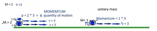

'speed' (or velocity) is the measure of 'motion' and is related to KE, a unitary mass acquires 'speed' equal to the square root of twice its KE, as you know, if v = 10, in one second the body travels the distance of 10 metres
By 'mass' whe mean the total mass of a body, the sum of all unitary masses . The relation of mass and speed is like the relation between sweets and jars: if 1 jar contains 10 sweets each, 2 jars contain 20 sweets (2 is the total mass of the jars).
Why whould more matter in movement would imply more motion? – Chirac
2 jars * 10 sweets is 20 = the 'quantity of sweets'. Has a jar anything to do with sweets? jars by sweets = total quantity of sweets, p = m * v, masses by velocity is the total 'quantity of motion'.
Momentum is the quantity of motion that a body possesses p = m * v, and depends on the value of speed and the number of unitary masses of a body. The greater its momentum, the greater the force it takes to stop it, the greater the force of impact on another body.
