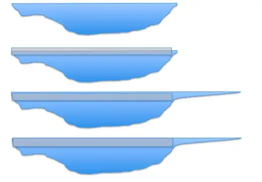

I don't think John's explanation is sufficient. If 3 feet (90 cm) of ice is floating, it should leave about 7 cm of gap (according to the 92% number) - that is not what was described in the question, which was "the same level as the surface of the ice". But I think there is another explanation.
Water level in bodies of natural water is subject to change, but once the ice on a lake sets solid (I consider 3 feet "solid") it's not going to move. Now imagine that the river feeding the lake supplies more water. Where does it go? There is no spare space below the ice - so it would have to go over the top. In doing so, the pressure of the connecting body will equalize with the top of the ice - which is exactly what the friend said.
So the picture is really like this:
At the top, the water is liquid. In the second picture, the ice forms - it floats as usual, and is about 8% above the surface of the lake. In the third picture, the external water level rises ever so slightly. The top of the ice (which is stuck to the sides) is flooded, and the water will freeze. In the final image, the water pressure below the ice is now greater than atmospheric. And if you cut a hole, the water will rise to the level of the top. Because if there is any fissure in the ice, a greater pressure than this would have been relieved until it was exactly atmospheric.
A few mechanisms that can cause the rise in pressure include decay of organic matter or photosynthesis (either of which will generate air pockets that cannot escape - these will increase the pressure on the water), underground wells, or, as I mentioned before, supply of natural water (runoff, rivers) from communicating waterways.
Regarding the question of "the ice moves because people stand on it": even a tiny displacement of the ice (say, because of the weight of people on it) with a sealed ice sheet (no holes) would cause the water to rise up in the hole - it has nowhere else to go. But it could be argued that such a small rise in water level would lead to substantial buoyancy effects on the ice (because of the large area affected by the small pressure change). Two people and their snow mobile ~ 400 kg. 7 cm of water = $7 g / cm^2$. If the area of the ice sheet that bends under the weight has a radius of 10 m (remember this is almost 1 m thick... so very stiff), the water level would rise (working in cgs, $\rho = 1 g/cm^3$): $400,000 g/(\pi\cdot (1000 cm)^2 \cdot 1 g/cm^3) = 0.1 cm$ - a negligible amount on 7 cm in effect preventing this displacement. Thus I'm pretty sure it is only mechanisms that change the amount of liquid / gas under the ice that can give rise to this change is static pressure - while the ice itself can be considered unmoving.
Key is that as long as there are factors that increase the pressure, it will always equalize to the surface of the ice as the ice sheet is unlikely to be a perfect seal, and spillover will just move (grow) the ice surface by a tiny amount.
