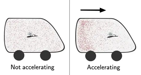

  2. If the car is accelerating, the situation illustrated in the image below will apply. The acceleration will cause more air to collect at the back of the car than in front. Therefore, the density of air at the back will be more. And hence, to move back, the mosquito will have to displace more air per unit volume than it will have to move forward (or remain stationary). So, this difference in densities of air in different sections of the car will help mosquito keep up with the car.
