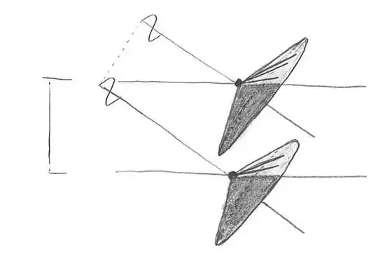

Here you see a figure of two crystal planes, separated by the distance d. Two parallel and in-phase x-rays hit an atom in the planes. The scattering cones are drawn. The darker area represents those scattering directions going into the crystal itself, and thus not detectable and uninteresting for XRD analysis. The light area are those scattered rays exiting the crystal.
Thinking in three dimensions is different from thinking in one dimension. To achieve constructive interference, the rays must travel in the same direction and also be superimposed on each other. Even though the scattered rays ' angle is, say, 45 degrees, they may not travel in the same direction.
However, if Bragg's law is valid for 45 degrees, all rays of 45 degrees scattering angle will interfere constructively. So we would get a diffraction cone of increased intensity. However, we cannot detect the whole diffraction cone, partly because some of the rays travel into the crystal, and partly because the detector surface area only covers parts of the diffraction cone; we would measure a curved segment of the diffraction cone. This is called the Debye-Scherrer ring, yes?
Though we get constructive interference in all directions of 45 degrees scattering angle, the scattering angle itself is random. This means there are scattered rays which do not undergo constructive interference in all directions, regardless of angle (though smaller angles are more probable). So, in an ocean of random scattering, we have diffraction cones of much greater intensity, since Bragg's law is fulfilled.
Is this a correct assessment of the XRD situation?

You are mistaking the mechanism by which part of the wavefront is used selectively for the phenomena in which the selected bits interfere with one one another and create a pattern.
I have a (optical) teaching spectrometer that uses a reflective diffraction grating, but it is also common to use diffraction gratings in transmission mode.
There are some nice pictures of reflective diffraction devices in the Wikipedia article on diffraction gratings.
Selective reflection or transmission is how you partition the initial wavefront. Diffraction is what happens when the selected bits interfere resulting in a macroscopic pattern in the angles of outgoing signal.
Also possibly helpful on Physics: Why is it difficult to differentiate between interference and diffraction?
What really happens is scatter: electrons in individual atoms scatter the radiation. For certain directions, the scattered waves interfere constructively. Because this is explicitly an interference phenomenon it is called "diffraction" - but the construction of the wave fronts and their propagation is indistinguishable from what would happen if you considered the atomic planes to be mirrors.
Of course when you use the Huygens construction on a conventional mirror you can try to convince yourself that that is "diffraction" too...
