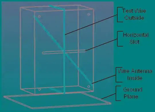

Second, gaps do occur. In a well designed microwave the gaps have compliant conductive seals; but if these lose their springiness I can see how currents flowing around the gap will result in re-emission of microwave energy. You don't need a 2D opening: just a gap that is "long and thin" is sufficient to act as an antenna. Where "long" is a few cm (1/4 of a wavelength). See for example this diagram:
from http://www.interferencetechnology.com/in-situ-emc-testing-using-surface-current-sense-wires-1/ which describes some of the techniques behind using such an "antenna".
